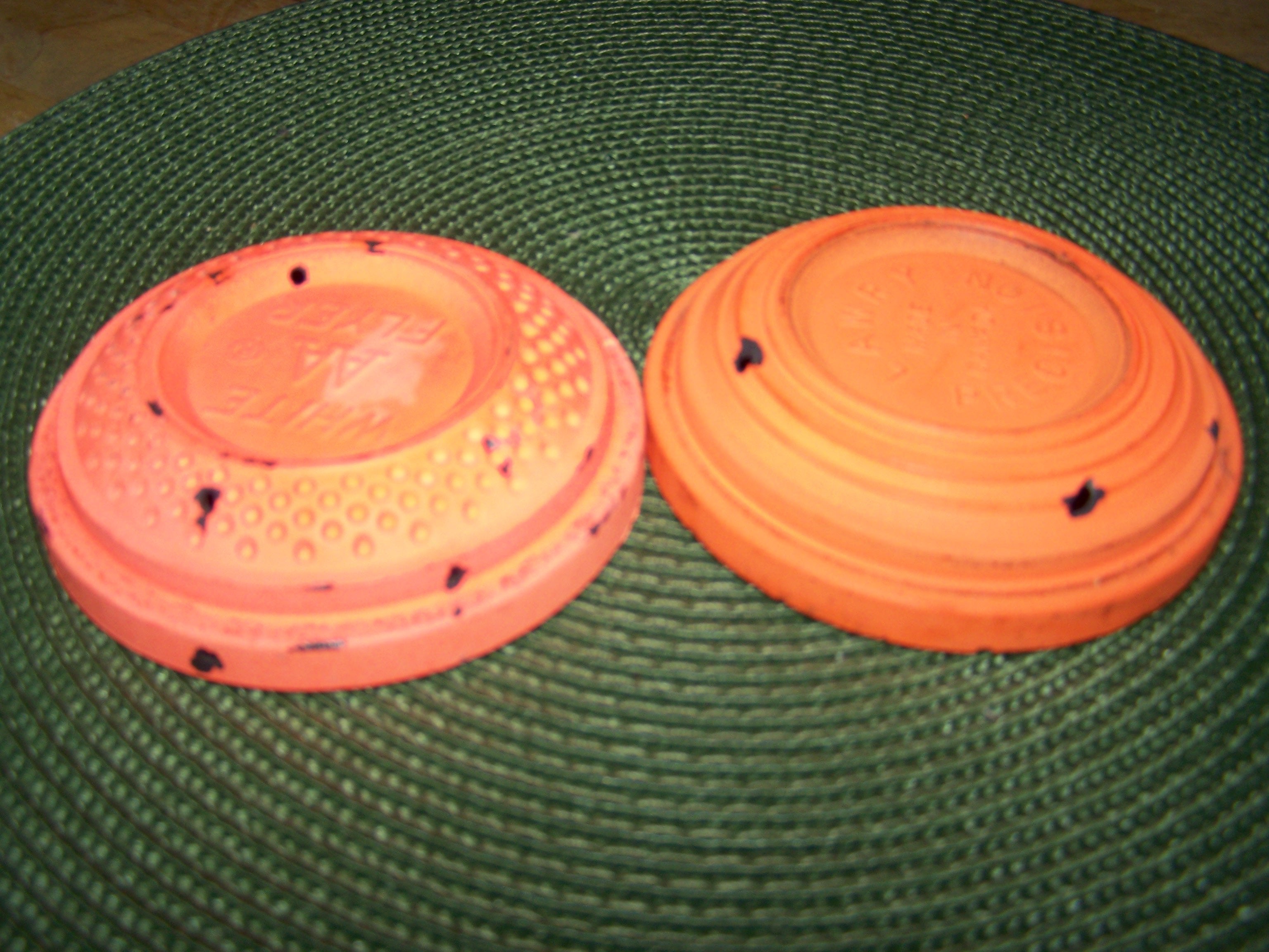

I've gone out many times and picked up unbroken targets at several ranges. I've found a number of targets with 5 holes in them and still landed, intact.

Just this past Saturday, I picked up targets at my club, White Flyer Bio’s. I did see many full targets with one thru hole plus small chips off the dome. I do not recall seeing any with two thru holes.
Only targets with no thru holes and no cracks are picked up. Next time I will look closer.

#15 ·
Jerry is right, its the energy that's in the spinning target that makes it come apart.
And the answer to how many is: one pellet with enough energy in the right spot to break a target.
Gun club porch talk will bring up the time they found a clay out in the field with 5/8/10/15 holes it in and attempt to show that as proof as the minimum number.
The problem with that theory is that it's based upon survivor bias. All you verified is that that specific target didn't break. Not what actually breaks a target since those are all broken and in pieces in the field.
