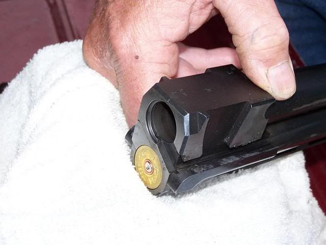

What we have here is a standard Remington 3200 trap. As you can see in the pictures the bottom barrel has a rather odd gouge in the chamber. The pictures are somewhat misleading as it just looks like a scratch. I assure you that it is indeed a noticeable cut. I estimate this to be a minimum of .010" to .020".
This gun belongs to a long time shooter and dear friend. I'm/we are uncomfortable with this condition, thus I'm asking the wealth of knowledge here for opinions... LOL
Obviously this gun has held together, but is it a ticking time bomb?

Shoot it......You got another .250 worth of metal at a minimum. It's near the head of the shell.

Are you taking about the mark @ 6 o'clock on the bottom barrel (if your looking at the barrels with the rib @ the top)? Looks like a firing pin drag mark to me.

The area that I'm trying to show (Not Well) is a circular gouge/cut that runs from the ejector relief counter clockwise (as the pictures shows) to left of the chamber.
It truly looks like a tiny scratch, but again I assure you it is a DEEP cut!

Looks like a dull boring bar cam out of a tool post and gouged the heck out of it...

Yes.. that 360 degree ring is machined into the mono-block.. The headspace is reamed into the monoblock.. not the barrel.. The barrel is a flatbacked tube that fits in the monoblock.. While the mono-block is being made..it ends the problem of cutting the barrel in the mono-block after its made.. If you look inside many barrels.. you'll see that line..just yours is a little easier to see..

That's one for the X-ray machine before I'd feel comfortable either shooting it or standing close to it. Looks like a stress crack to me!

Does it look like the ring in these mono-blocks?? Look in the mono-block in the receiver.. That ring you see.. is the shoulder the barrel rests on.. That's how its done.. and been done.. for a long time..

It's behind the basewad of the shotgun shell..and is good.. high quality steel. With the plastic basewads of today.. There is no problem. The Cole.. which is one of the strongest shotguns ever made..has had NO issues with this design. I have chambered rifle shells with 55,000 psi chamber pressure.. proof 70,000 psi with no failure.. M<any of the old paper shells would blow out in the rim..and some gas would escape ..But that never hurt the receiver,barrel,or gun.. The shooter could get gas in their face..

I can tell you one thing.. The TI Cole was tested to destruction.. We never managed to damage the receiver at all.. and we were well over 20,000 psi before the barrel/mono-block showed signs of failing at a vastly different location..

Now can we consider a void in this chamber a problem, or not?
We can "what if" this all day... and error on the side of "safty"...
Do you see what I'm saying?
