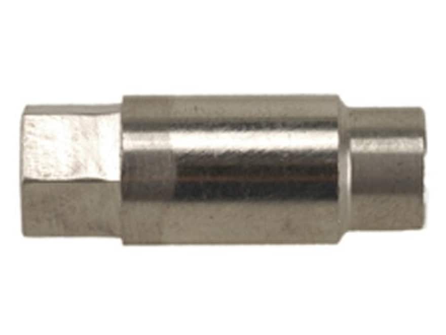

The Weatherby / SKB has a block down below, and the crossbolt. I would pull the stock first. Since you haven't had any problems locking up, it may be as simple as a new lever spring. Inspect the block , and the crossbolt also. This is a good time to inspect your firing pins and springs also. This tool
makes that job much easier.
