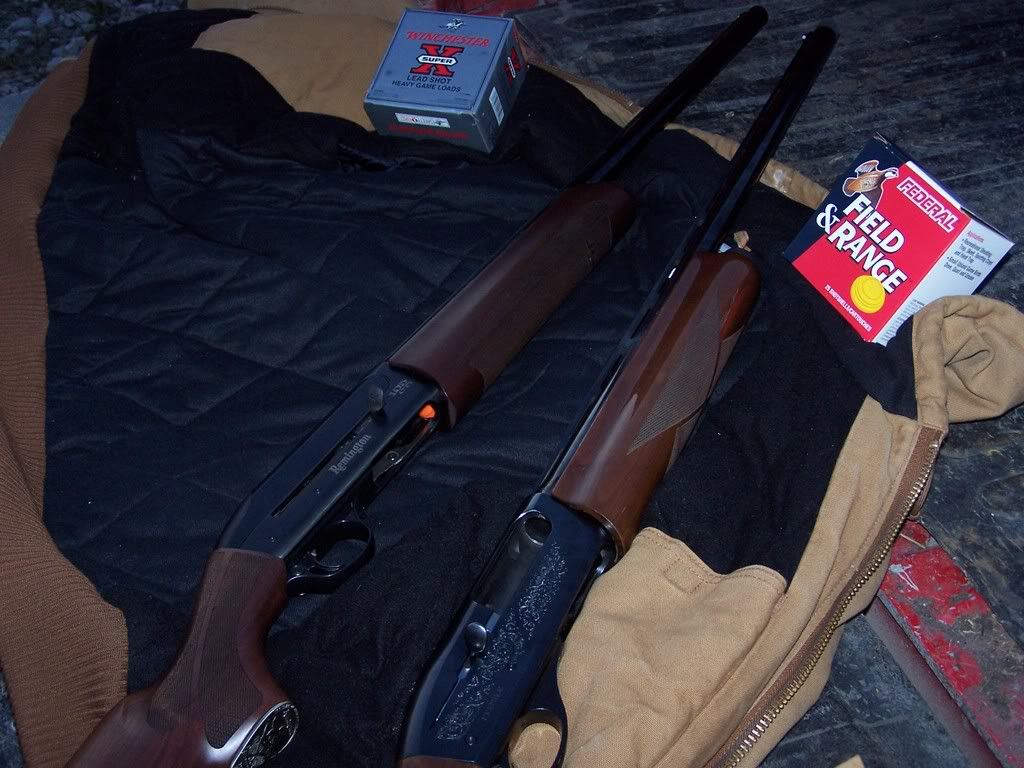

Had nothing to do, so we decided to take it through a little test run compared to the Remington 11-87. Our conclusion...11-87 is the winner. Here's what we did:

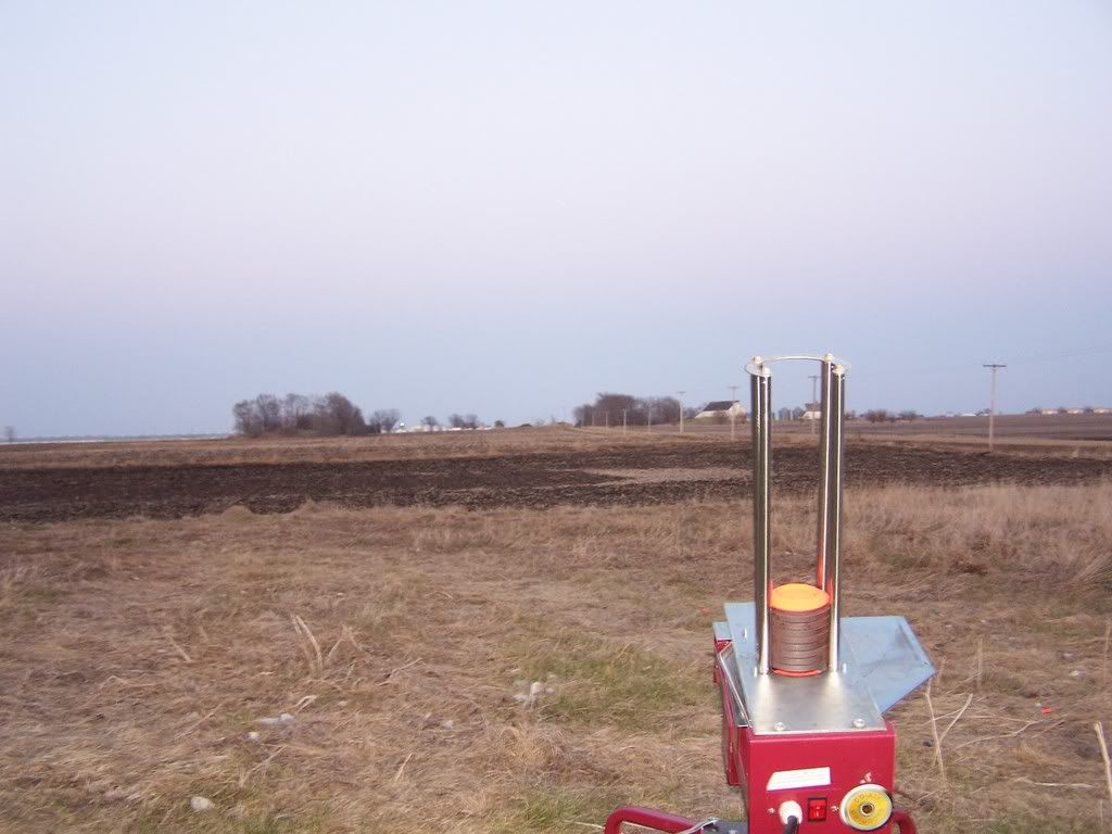

We set the thrower up:
...and started throwin some clays. The way the action worked, is when you load the first shell, you push it half way into the magazine tube and let go, the spring pushes the shell into the release in the action, then the "fork thingys" lift the shell towards the chamber while bolt pushes it in...it's a wierd set-up compared to a "normal" semi-auto. The only problem with that is, when the shell fires, there has to be enough kick-back to push the bolt back far enough to lock it back. The first shell we shot, was a Federal " ", they are how we found that it takes good pressures to get it to cycle right, it would fire the first shell and kick the hull out, but the bolt wouldn't go back far enough to cycle the second shell, very frustrating as you can imagin. So, we tried some Winchester " " shells, and when you put them in, it would cycle without a problem. The "bolt-release" (if you want to call it that), is a little sliver of metal almost like the bolt-release on the 870's, only smaller, and pointier(sp?).

According to the description of the gun, "The amazing 48% reduction in recoil is accomplished in a four-part dampening process. "...yea...right. This thing seemed to kick just as much as the 11-87 if not more at times with the same ammo. Though the action cycling was not noticed as it is in many autos (11-87).

The chokes in the 105cti are also not standard Remchokes, but instead, they have been redesigned for a reason we do not know, other than maybe because it is over bored...they look expensive, yet not any nicer than a regular Remchoke like what was used in the 11-87.

After finding that the Winchesters worked well and made the gun cycle right, we decided to give a rapid firing test. The 11-87 performed flawlessly (as always) as did the 105cti, but the cti seemed to have more "muzzle climb" due to it's low weight and noticable recoil.

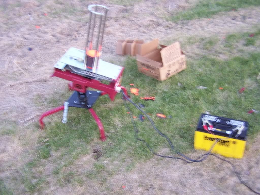

Also while testing, we used one of "Do-all's" Aerial Assault traps (as seen in picture above...$499.99 at your local Cabela's). Very nice trap for the money. It will throw very consistant and fast birds all day long and re-cocks itself relatively quickly. But, after about 10 cases of clays, the foot pedal switch started to fail, with some brief disection and work with emery cloth, the micro switch worked as good as new. Over-all, a very nice set up.

As a co-writer of this post with jolly I did most all of the assebly and mechanical work with the 105 though I havent yet take it completly apart i did notice the improved gas system. There is no more rubber O ring to wear out or get torn it has been replaced with a double metal seal that compresses slightly when the fore end cap is tightened it also has an extra band on the barrel lug/gas port yet another improvement in the seal. The main spring has been moved from the stock (like on the 11-87) to the forend cylinder. The stock now is home to the oil rate controler that supposidly makes it cycle at the same speed with heavy and light loads. This system needs a little improvement to work with the lighter trap loads. Also the bolt has gone from the 870 style lock up to a rotating head type. this gun is a good start but needs some refinements to make it better, it has potential but is still buggy.

i cleaned the action tube thuroughly and the only time it failed to feed was with the federal loads pictured the winchesters worked flawlessly.Im not sure about the stock intercahgability. The rear of the reciever is very similar the only issue would be the fit of the rate controler.

yea it is definatly a feild gun that with a little refinement could become something better. Some of the simple functions that you take for granted on a shotgun like the bolt relese and feeding shells into the magazine seemed to be overlooked in the development of this gun. the bolt relese button is small and pointy, the first shell that you stick in the magazine shoots back into the action then is slid into the chamber (cool part) but then when the action is closed and you load more into the tube the shells dont get alighned and you have to manuver them awkwardly in not a very smooth operation. With the right loads loded one at a time this can be a very cool gun..just the little things.

I have now fully disassebled the 105cti.I was suprised at the ease of disassebly and assebly. Almost easier than an 870. All you have to do is remove the trigger and twist the bolt lever remove it and then the bolt and gas piston slide right off. The action was spotless there was no unburned powder any where to be seen. The mechinism is simple and rugged not as many moving parts as expected and all parts were solid and smooth. Im am very impressed with the action but still slightly disapointed in the user friendlyness of loading multiple shells and the bolt relese.
