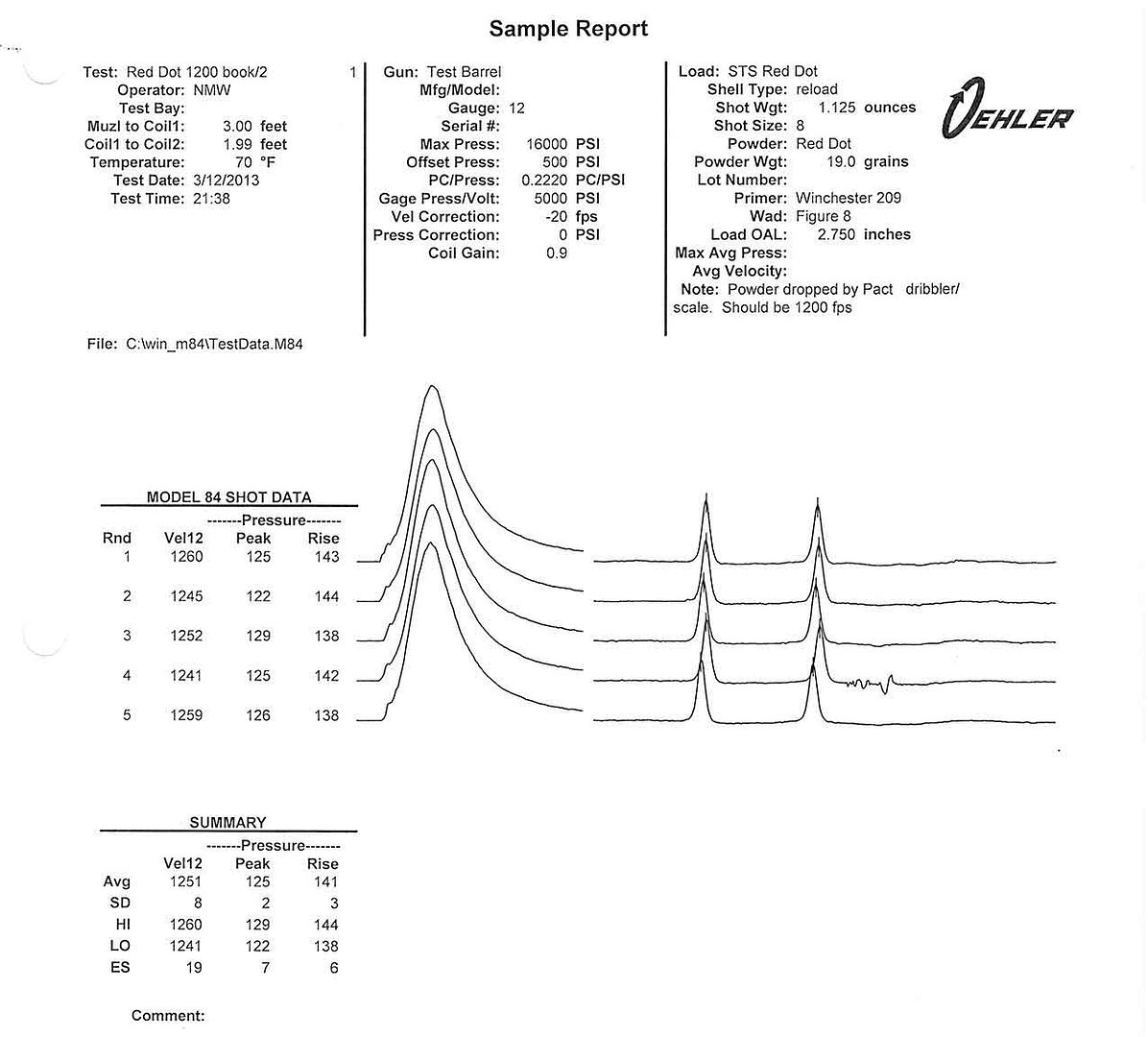

The Red Dot loads are a good deal more deviant. Here’s 2009:
And 2013:
These are more of a problem, in that they are both about 50 fps faster than expected, and, once again about the same, 1248 fps and 1251 fps.

Neil, in your first report of 2009 sample sheet shows 19 grains of Green-dot as the powder, shouldn't that read Red-Dot instead? I like the SD number "6" of that Red-Dot load.

Hap. You are right that in the right-hand side near the top, in the section called "load" the powder says Green Dot and should say Red Dot as it does in the rest of the sheet. I see that I did that test 20 minutes after the Green Dot one and I guess I just failed to change that aspect of the test. A feature of the program is that you can't edit anything in a completed sample report, a firewall against "improvement" in results.
The barrel I use is a SAAMI-type, 30 inch, but it is cylinder rather than the SAAMI-spec full choke. That basically accounts for the "-20 fps" in the Vel(ocity) correction in the middle of the upper sample description. This is a difference between the inductive chrono I am using here and the consumer (light-operated) ones people are familiar with. With an inductive machine cylinder chokes result in faster reading, not slower as with the outdoor models.
