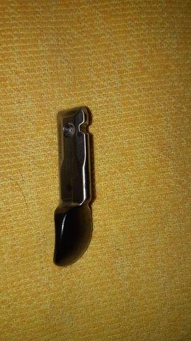

I just acquired a new to me Remington 1100 Trap. The code on the barrel is CB and apparently indicates it was manufactured on April in one of these years: 2007, 1981, 1956, 1933.

Anyways, on the initial range day the operating handle fell out, luckily I was able to recover it ... however it must have been a problem for the previous owner as well as it had copious amounts of JB Weld on it.
I disassembled the gun and have cleaned the JB Weld off, the ball and spring retainer seem to be working properly with good spring, the handle seems to fit in properly and is fairly tight however I'm told by vets at the club that it should be harder to pull out.
So a couple of questions ...
1) Apparently there are two types of handles, how do I know if I have the correct one for this gun?
2) Any suggestions on how to make it snug in a little tighter?
Thanks
This is the one I have now:

1956 and 1933 are out, as the 1100 was introduced in 1960. That looks like the newer one; it is designed for the two different types of detent ball arrangements; The old style where the ball was on the bottom, and the new style where the ball is on the back. The only way to make it tighter (JB Weld obviously isn't the answer) is a new handle-or fill in the hole for the ball with TIG weld, and gradually remove material until you get the right fit.

So are you saying my gun was probably manufactured in 2007?

The handle must match the action bar and the action bar detent spring must be operating correctly.
If you buy the part new from Remington (according to their picture for the part on their web site), it will have both cut-outs for the ball-bottom and back. Obviously, if using an old part, you have to match it up. I don't know about all current models of 1100/11-87, but my 1100 Competition's op handle only has the back cut-out for the ball.

If the operating handle is too easy to pull out, you likely need a new spring under the detent ball. It should not just fall out under recoil. The old style with the ball on the under side are not difficult to replace. the newer style with the ball at the rear of the o.h. are more difficult, having to drive out a drift pin.
