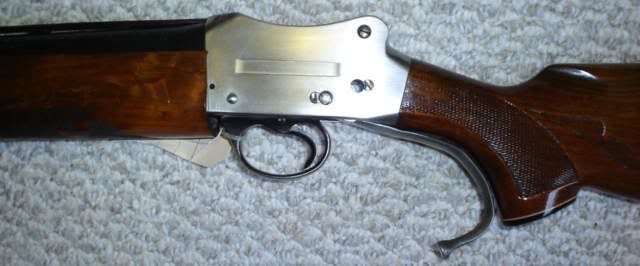

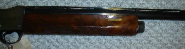

I'm trying to find any info on this gun, it's in the St. Louis area.
It has a 34 in Remington barrel and it looks like a straight 1100 trap stock and forearm,
if anyone recognizes this gun or has any info on it, I would appreciate hearing about it.

About ten years ago a guy in Indiana was putting guns like this together and selling them . I have seen four or five and all of them shot poorly as in low-right-left . He was buying the Actions and doing most of the work himself . The ribs were very poor . The thing was a novelty at best .
Your find may be defferent but look at it closely before buying .

Greener Built a falling block trap gun it was a WW Greener, Donald Van Brimmer
of Delaware Ohio had or has one, he shot it very well.
Built by a guy in Indiana don't know, maybe, maybe not.

The action is a Greener Police gun, used in India in Colonial times. They had a shotgun shell that had a stepdown in the length of the tube, so if the gun was stolen, regular 12 ga. ammo didn't work.
I had an acquaintance that bored the chamnber out of one and shot trap with it.
The rest of yours looks like a morsel of hangover genius. (no offense intended)

hi mike, there was an instructor at the colorado school of trades in lakewood, colorado, when i was there that ran the shotgun department who built and shot greener shotguns he converted ( i graduated in march of 1979).very simular to the ones in your picts but made to be takedown. i have one i converted in school still around here. i remember the weak point being getting a good trigger on the gun. the one i built i sweated the choke into the barrel (before screw chokes). i has a simmons rib. srong actions. fun to shoot. doug hubbart

There were several of these guns converted to trap with vent ribs back in the 1960's I had a 30 inch one GP Greener Martini actions. They are built like a tank a falling block design liked to shoot it until I went to a release.

It came in Friday, so of course I had to go shoot it Saturday at the club.
Weighs 7 1/2 pounds and even with the 34" barrel it was light and fast. Broke the first 5, so that's a good sign.
The barrel is actually a "34" 1100 Duck/Goose barrel, so it's tight choked and flat shooting. Patterns straight and about 60/40 for me. It has an 1100 straight trap stock and it figure 8s the beads right out of the box.
It actually has a unique way to attach the forearm to the barrel as seen below;
a machined adapter fits through the magazine tube attachment and a forend nut with a bolt welded in and machined off flat.
<a href="http://s82.photobucket.com/albums/j265/mjeter_2006/?action=view¤t=attachmentinbarrel2.jpg" target="_blank">
<a href="http://s82.photobucket.com/albums/j265/mjeter_2006/?action=view¤t=GreenerAction.jpg" target="_blank">

Nope, has an o ring on the adapter, just like an 1100.
Vents through the forearm, just like an 1100.
