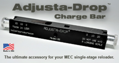

I’m glad they are producing the adjustable charge bar. Some people like them.
I didn’t see one for progressive MECs.

Wondering if there is a way to lock in the adjustments once they are set how you want them - and if not, if they could change slightly with all the bumping and banging from the machine?

Another photo on the website, better contrast. You can see two holes on the ends. On the original bar, this is where two set screws were. I am assuming it is the same with this new bar, you lock the settings with the set screw using an Allen or hex key.

What's been the overall experience with accuracy? I would try one for my 9000 if/when they make one, but I feel like I would need to weight my load way more often then with a bushing. I'd be too scared they would back off over time.

It’s always a good idea to check your powder drops from time to time. The accuracy is around two to three tenth of a grain depending on the powder that you are using . So just as accurate as using a bushing . There is a set screw to keep your settings from changing. So that should not be a problem.
