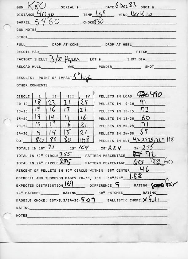

Here’s one of my data sheets.
Now if that doesn’t establish my credentials as obsessive-compulsive I don’t know what would. Six concentric areas, four quadrants, all the rest of that calculation and computation. It was only 1983 of course and I was only a year into it, and I see that by 1985 I’d thinned it out to just pellets and percentages and all the rest of that had gone by the boards because not a shred of it was reproducible. Three consecutive patterns never got the same rating, the patch-count never duplicated, and informally, it became clear that I could reproduce any of the “differences” I’d admired in magazines just by shooting a half dozen using the same shells and picking patterns which would illustrate any point I wanted to make. You want even? Pick shot three. Patchy? Pattern five illustrates that. Six has an unusually even distribution, don’t you think? Let’s call that Super-Lite powder for an upcoming article.
I’ve got hundreds and hundreds of these pages. The number of birds it got me is unknown, but not large, other than by patterning I found a lot of barrels that didn’t shoot straight and saved myself a lot of grief that way.
