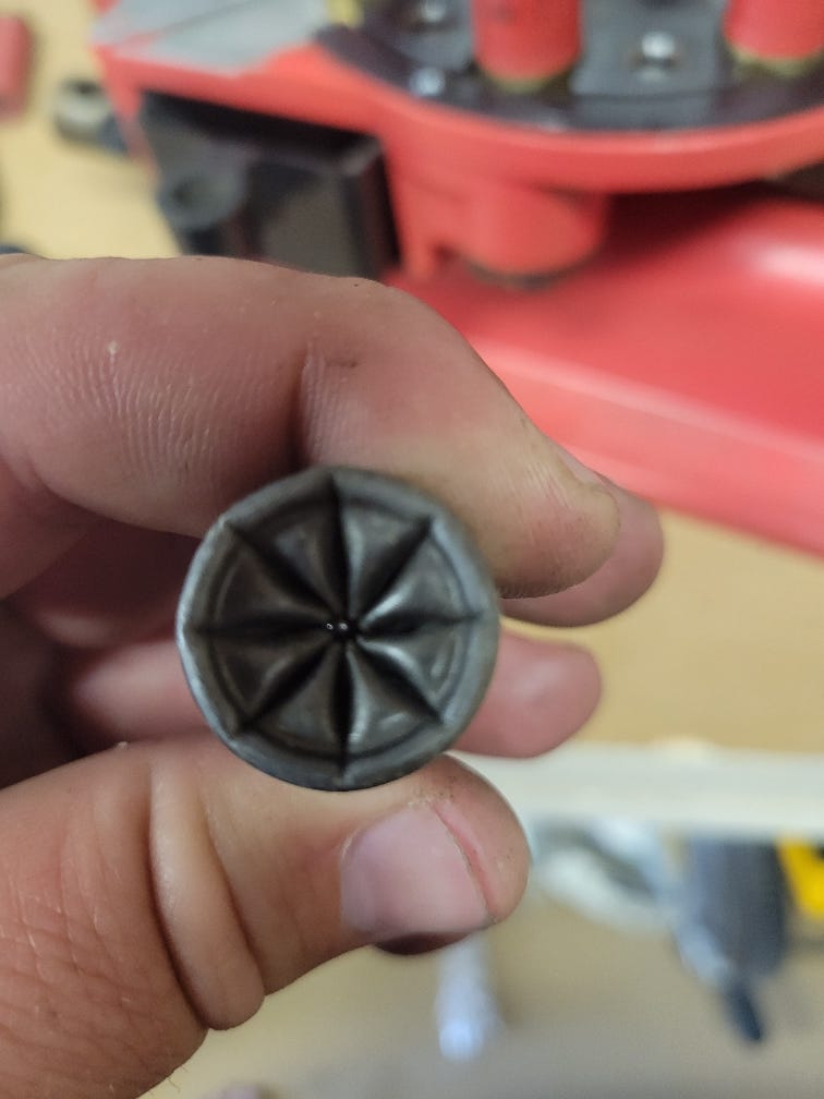

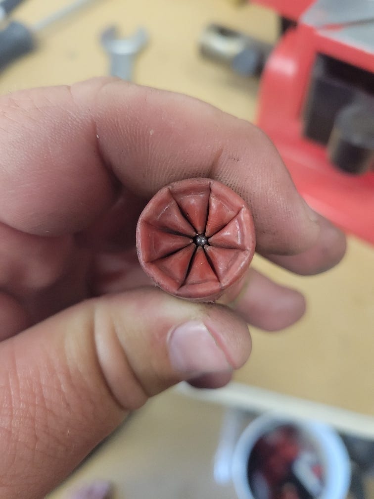

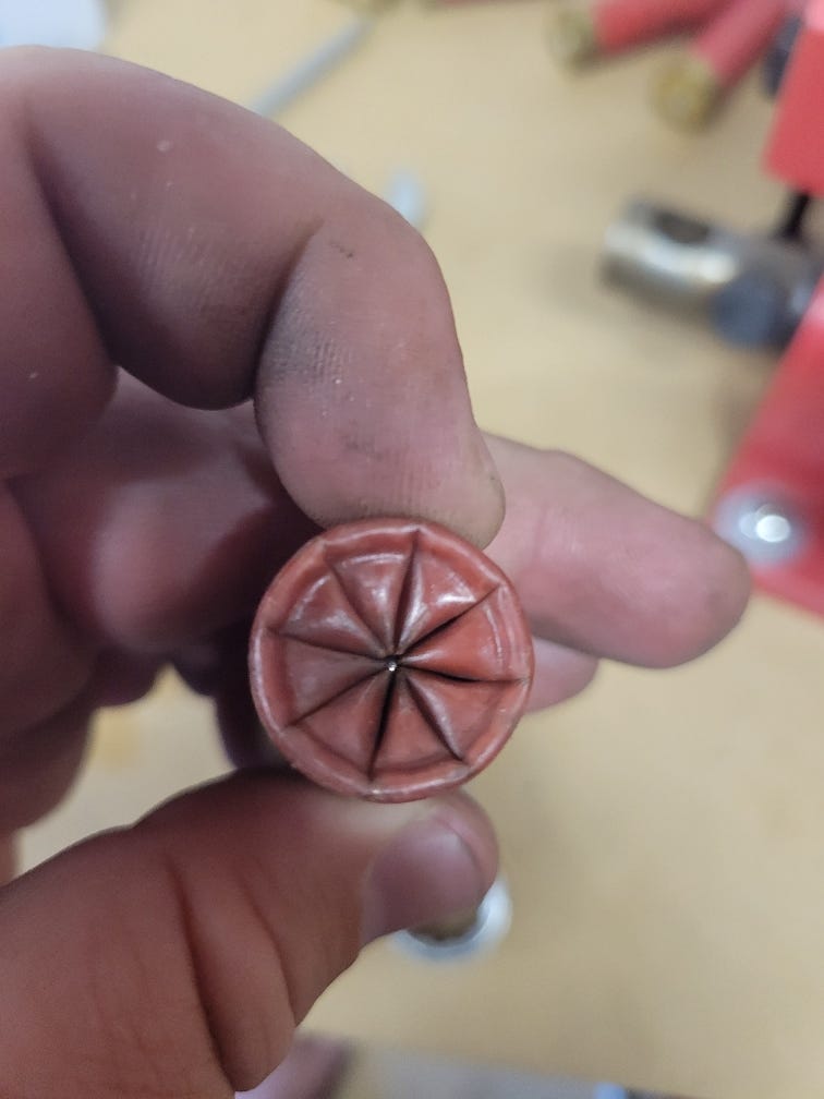

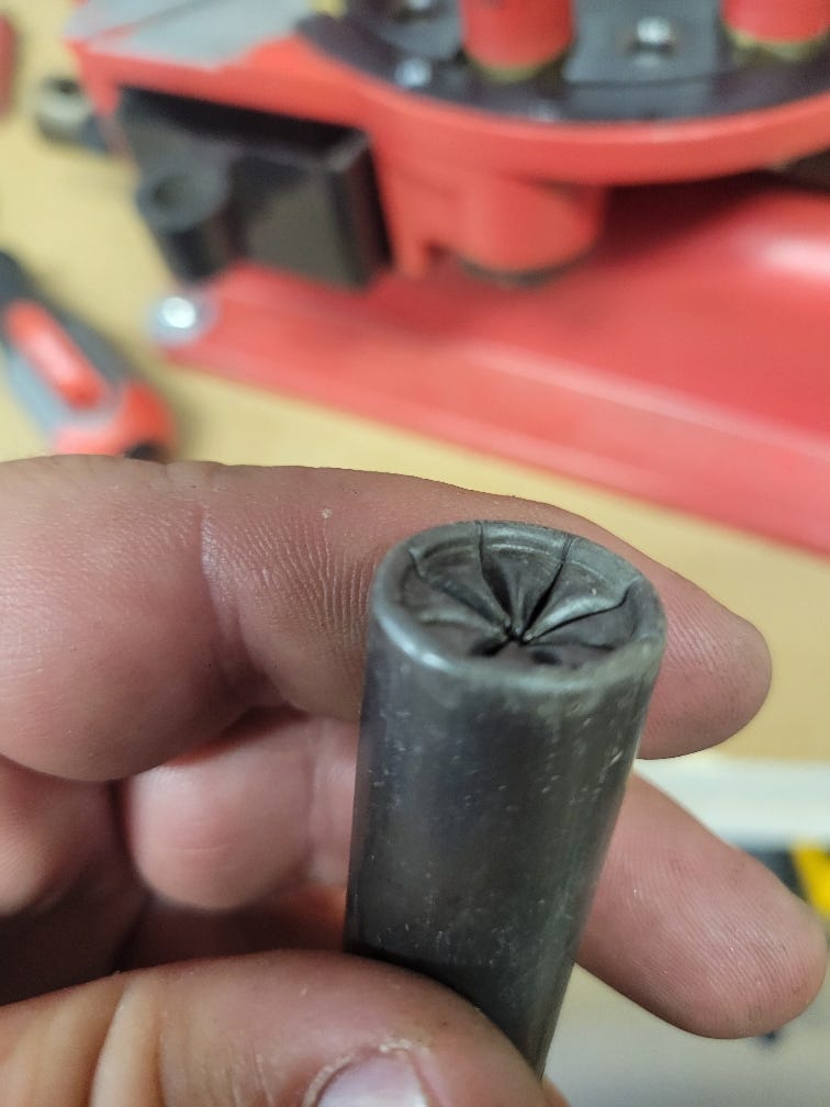

Hey all
I've got my press mostly working! And have loaded about 200shells. They go bang and most of the time the clays break! Attached are pics of my finished rounds, I seam to end up with a small hole in the crimp and the occasional pellet falls out. My pre crimp is set to leave about a 3/16 gap and my final crimp is set at 11 threads. Any help on what adjustment I need to change would be helpful.
Using AAs, 15.7gr 700x, 1oz #8, clay buster 1100 wads
Thanks
Sent from my SM-G991U using Tapatalk
Laserman, welcome to TS.com. A couple of observations:
1. Your crimp depth is too deep. Adjust the center of the final crimp die upward a half turn at a time until the depth is the thickness of a dime.
2. I'd say your stack height is a bit short. How much, if any, wad pressure are you using. If you are applying significant wad pressure, adjust the wad seating die upward a half turn at a time until the wad pressure indicator just wiggles a bit.
Try these two adjustments and then come back and show us what you have.

I had never adjusted the wad plunger... I just rose it up a bunch to the point where it slides the wad in just to touch the powder, the Guage doesn't move. I backed the crimp plunger screw out a turn, then back in a bit. I understand how the crimp plunger is adjusted, but not totally sure what the effect of turning the die body up and down does.... It's currently set to 10 threads. I would guess the stack still seams a bit low. I'm using some old clay busters they are white, not the new pinks, but I doubt the age is the issue. The crimp depth at the edge is .056in
Looks a bit better but the level of the shot in the hull still looks low. Are you sure those wads are 1 oz?
The reason the adjustment of the crimp die body is important is because it's tapered on the inside and that hull you're using is straight walled. Adjusting it upwards reduces pressure on the sides of the hull. Hornady makes a straight walled crimp die body that's available on special order. You have to ask the for it.

Thanks for the help everyone! It was the wads. I bought this setup used and it came with a bunch of wads. I know the cb 1100 are supposed to be pink, I just assumed the bag I had was labeled correctly and they just used to be white. Needles to say the previous owner must have thrown 1 1/8 Oz wads in the 1 oz bag. I switched to the proper pink ones and now it's working! Though in the process I broke my crimp starter....

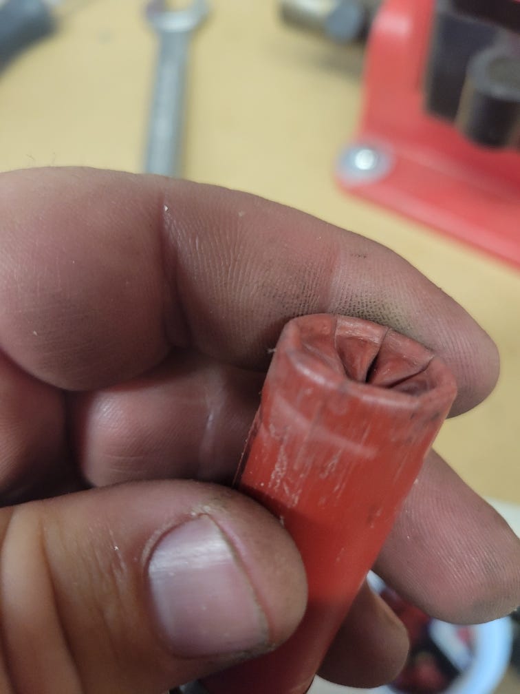

Hulls are AAHS. And you are confused. The legs on the 1 1/8 oz wad are shorter than those on the 1 oz. wad. You use the 1 1/8 oz wad with the HS hull with 1 oz of shot to bring the stack height down. He put the 1 oz wad with the longer legs in and increased the stack height too much.
The pics in original post were dished. 15.7 gr is a pretty light load. Looked like he needed taller legs to me. Mebee I missed something. But, I was thinking reverse, good catch. Less room in hulls would take a shorter wad, but he needed a taller wad according to his first pics.
But, I googled crenellated, and still confused on what it referred to on a crimped hull, splain it to me Lucy.
The pic of the crimped hull with the channel locks in the background is crenellated. He does need taller legs only the 1 oz wad he went to had legs that were too tall, resulting in a tented and crenellated crimp.
