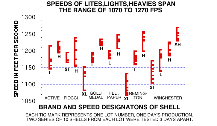

    The first Handicap Shells I was aware of showed up at the Spring Grand in about (correction here from 1992) 1990. I've still got a box or two and I just tested a couple and they (after correction) are about 1275 fps, measured by SAAMI-like equipment which had been calibrated second-hand and only first-hand really counts. But they were killers in the recoil department and were soon toned down.
    There were plenty of 3-dram-labeled shells which were well over 1200 fps and right in the sweet-spot for handicap shells being sold today.
    [​IMG]
    So the higher scores being shot today are _not_ caused by "handicap speed" shells which we'd never seen before. We were shooting them all along, but didn't know it. Top long-yardage handicap shooters are firing today shells about like they did 25 years ago. So that's not the cause of the higher scores they are shooting today. The big difference is that today there are so many more of them.
    Neil

    I don't think you got the message from that graph, u r 2. All that happened when named "Handicap" shells showed up was that the span of speeds people shot were divided into four layers instead of the three layers that were used before. Look at the WW shells on the right side of the graph. The range that is three for the others is four for WW. They are just closer together, that's all.
    I checked and I did those tests in 1990. The top shooters were shooting "2013 Handicap-speed" shells then, but they were labeled "3-dram." Nothing has changed on the trap field except 3-dram has been toned down some, sometimes, depending on the particular lot number you bought by the luck of the draw. And so on down the line.
    Phil Kiner may be - well, let's agree he is - right when he says that Handicap shells over 1200 fps are worth a bird in a hundred. The top shooters today are not winning by a bird over the rest of the field, they are winning by several. So it makes no difference as to who ends up where. People who think "If we just slow down the shells the big dogs shot I'll be more competitive" are dreaming.
    The best shooters win so much because the are not twice as good as the rest of us; they are in a different galaxy. In terms of shooting a winning score they are at least ten times as likely to do so than someone with a 90 handicap average. That's just the way the math works. And why in the world do think that if slowing shells down a bit is going to reduce a likely winner's score by a bird that it won't do the same to yours?
    Neil
