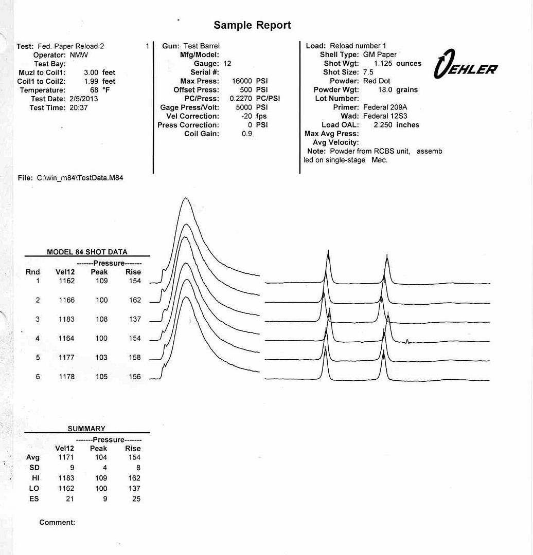

    I decided to replicate that experiment as best I could with components on hand. I used 18.0 grains of Red Dot as dropped by an RCBS scale/dispenser combo. I used Federal 12S3 wads, Federal 209a primers, and put the shells together on a single-stage MEC, the perfect tool for this sort of thing. I used six shells since they fit so nicely into the six compartments of the small Frabill tackle box I used to keep the hulls straight.

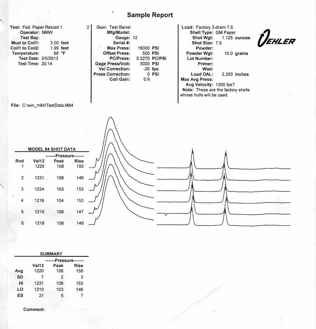

    The chronograph is an inductive Oehler Model 84. Let me introduce you to its data sheets. The top third are the conditions, components, and so on. The middle third are the individual shots: their velocity, peak pressure, and the rise time of that pressure.
    Below that is the summary for this test, standard chronograph variables: Average speed, the standard deviation of the speeds, the high and low rounds, and the extreme spread. To the right of the speeds are the same summary statistics for peak pressure and rise time.
    Here are the shells I emptied to get hulls for the experiment.

    And the first reloads.
    [​IMG]
    The factories are a little faster, but the SD’d are similar, 7 and 9, and the extreme spreads are the same, 21 fps. It’s clear that for first reload you can duplicate factory speed performance, though the reload pressures are a bit more variable, with an SD of four compared to the factory’s remarkable two.
    But those non-zero SD’s and extreme spreads are a warning that single shell (N=1) tests are certain to provide less “representative” results than tests with more shells.

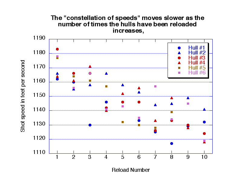

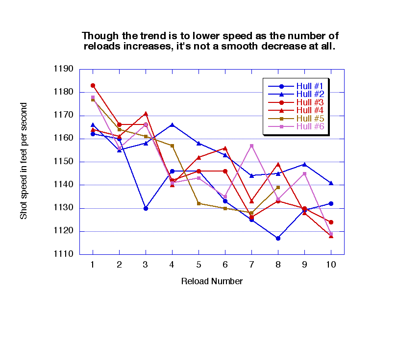

    Those results are always full of variability, no matter whether they are factory or reloads. Here are the raw data which will need some cleaning up before we can see the detail of what’s happening. Notice that every hull shows dips and rises in its slow trek to slower speed, but in the end they all get about as close to each other as they started out.
    [​IMG]
    All those lines just confuse things and we aren’t really interested much in the speed history of a single hull but rather in all of them. The following is probably the best way to present the two salient variables of multi-reload testing, where the speeds are headed and how consistent are the results. Let’s lose the lines connection adjacent data points and . . . here we have it, the results of the whole experiment which can be taken in all at once.

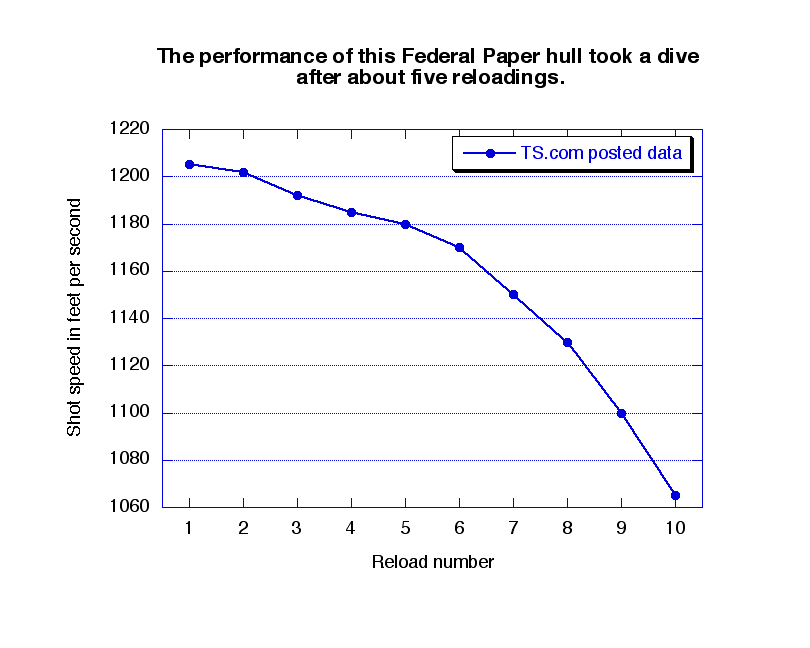

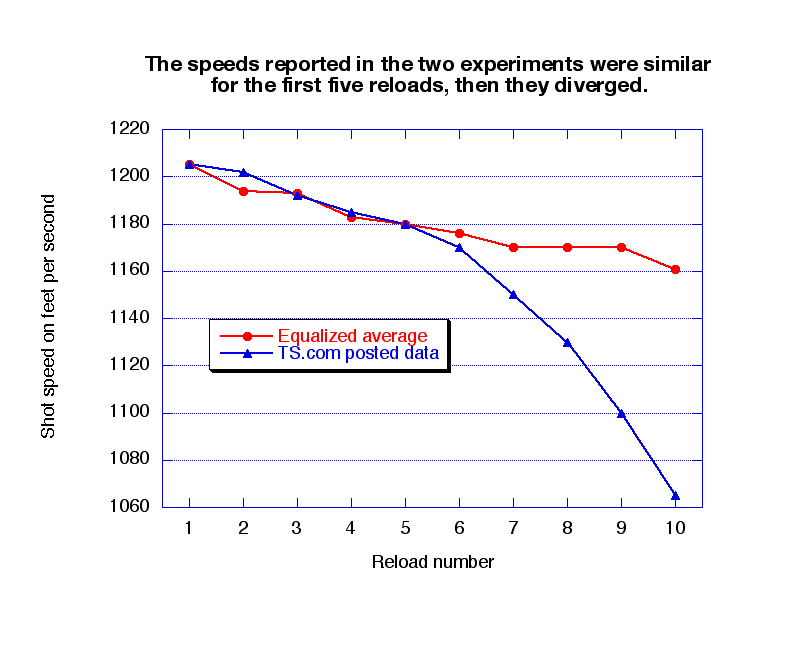

    The mean is another way to summarize data, but it can’t show variability in the way that graph does. But if we are going to compare these results and the TS.com data, it’s what we have to use. The beginning speeds are a little different but adding 24 (correction: 34, cited later in the thread) to all my data points gives us even starting points and here are the results of the test:
    [​IMG]
    As I suspected, the result of the test I saw here are in no way representative of the performance of Federal Papers in general when loaded with appropriate components. This illustrates the truth of my warning about single-subject experiments. Your subject may be an oddity and without more data to study you will never know it.

    Why does the red line on the last chart labeled- equalized average -have an 1160 fps when both scattergram charts above it show the tenth reload at about an 1130 fps for the average?
    Loads 8 and 10 both have results in the 1120 fps area.

    Bob (Butler) you are correct. Above I wrote "24" when the correct number was "34".
    I probably skipped over that a little too rapidly anyway; here's the complete story.
    [​IMG]
    Neil

    second question. How come you tested 6 starting at 1175 fps instead of the 1200 fps of the single hull test?
    Would seem to me that the data would be more comparable if the original speed of reload #1 matched the single hull test starting velocity.
    I am wondering now if the results of a 6 hull test started out at a higher speed would have any effect on the shape of the average results by load 10 due to the higher pressure and its effect on the hull.
    I think it is important to keep the FPS scale on the charts the same when presenting data as well.
    Makes for a better evaluation.
    I don't own a pressure set up and my Chrony is not that accurate. But I am a curious reloader. I see from this the value in shooting factory or once fired for when the score really counts.
    In the end does 40 fps matter, or a hundred?
